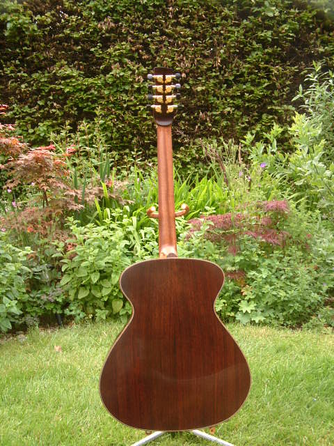

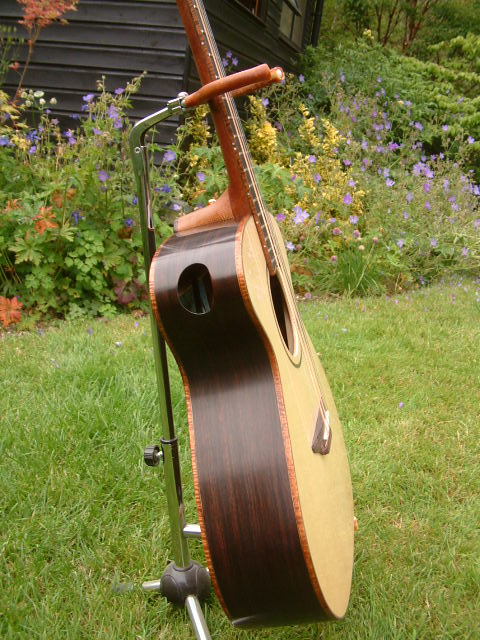

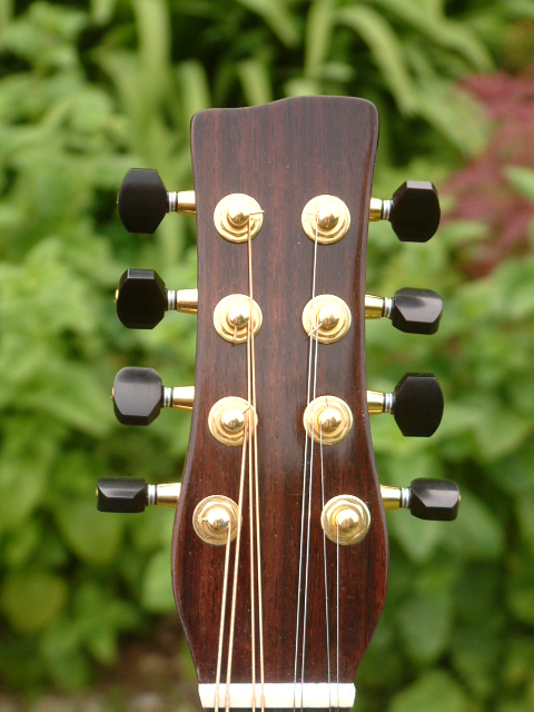

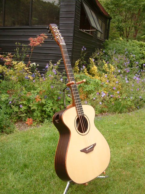

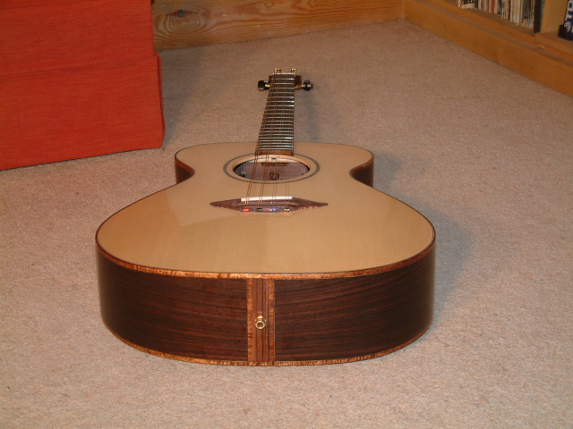

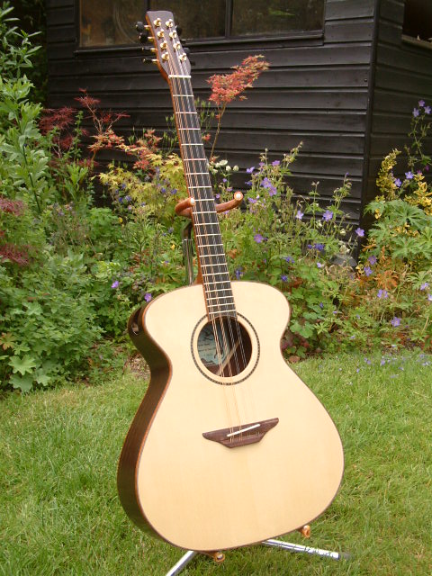

Just finished my 3rd guitar bouzouki - this one is a commission which is nice. The owner is a talented bhodran player that wants to learn a "proper" instrument and he will be picking it up this weekend.
It's Euro Spruce/Indian Rosewood (one of Shane's lovely sets), with curly koa bindings. The neck is sapele (first one of these I've done) with London plane heel, EIR front and back headstock veneer, ebony fretboard bound with curly koa and Gotoh mini tuners with ebony buttons. End graft and bridge are Kingwood. It's a 16 fret body join, with 25.6" scale length, 16" lower bout and 4 7/8" maximum depth and side soundport.
The strings have only been on for a few hours and it has plenty of opening up to do but sounds pretty good already. Here's a soundclip of me playing accompaniment and melody (not at the same time ) on Jim Ward's Jig (an arrangement I learnt from James Fagan). Tuning is GDAD and there is a tiny amount of reverb added:
Jim Ward's Jig
Now some pics:
Thanks for looking and listening.

Dave! Another fabulous 'zouk from you, refreshing as always! Your instruments are easy to recognize and it is fun to see how your style develops from instrument to instrument. For instance, that headstock is sort of odd, but very cool at the same time.
I have no sound on this computer, so I'm looking forward to tomorrow when I can listen to it (at work!).
A 40 mm nut is narrowish? The one I posted here a while back had a 36 mm nut and I have seen Irish bouzoukis with nuts at about 32mm.   I guess it depends on your playing style, but I imagine some finger stretches would become hard to do if the nut was much wider than 40 mm (but then I don't really play this instrument so what do I know).

Thanks. I came up with the headstock shape when I made the guitar-cittern and was trying to get as straight a run as possible on the 10 strings. It's grown on me and I now use it for all my instruments. On nut width it all depends on if you are coming to these instruments as a guitar player or mandolin/mandola player 40mm is I think what was used on Andy Irvine's original instrument. The stretches aren't that bad - that's why I use GDAD and not GDAE - and the solution is not to overcomplicate things and choose voicings that let the open strings ring.
